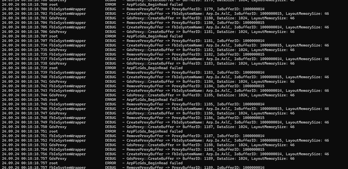

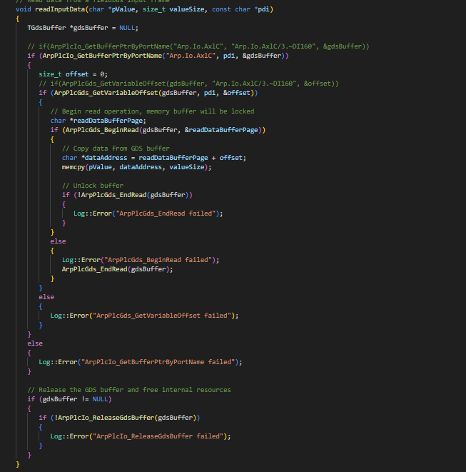

Hi everyone, I’m having an issue where I can’t use the runtime application to get the Axioline data on a axcf-3152 with firmware version 24.0.
SampleRuntime/getting-started/Part-07/README.md at master · PLCnext/SampleRuntime (github.com)
I followed the link above and it was fine on the 23.0 firmware version of axcf3152.
axcf-3152 firmware 23.0 The project update firmware from 23.0 to 24.0, and we use 24.0 toolchain rebuild the runtime project, but it doesn’t work.
axcf-3152 firmware 24.0
Is there any help to slove this issue? I found i can’t rollback from 24.0 to 23.0 now.

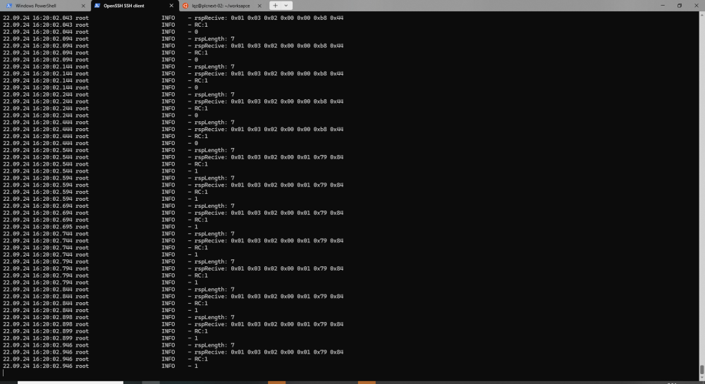

this is the ArpVersion infomation
admin@axcf3152:/etc/plcnext$ cat ArpVersion.properties
BUILD_VERSION=24.0.6.134
BUILD_VERSION_NAME=2024.0.6 LTS
BUILD_VERSION_MAJOR=24
BUILD_VERSION_MINOR=0
BUILD_VERSION_PATCH=6
BUILD_VERSION_BUILD=134
BUILD_VERSION_STATE=
BUILT_BY_JOB=jenkins-PLCnext-Yocto_Targets-Yocto_AXCF3152-release%2F24.0.x-134

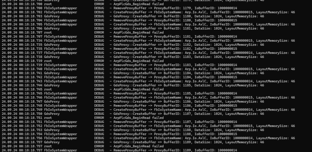

As discussed offline, a problem has recently been discovered with the ANSI-C interface that affects firmware versions 2024.0 and later, and which has symptoms similar to those described here. A fix for that problem is currently being developed and should be available in the next hotfix.
