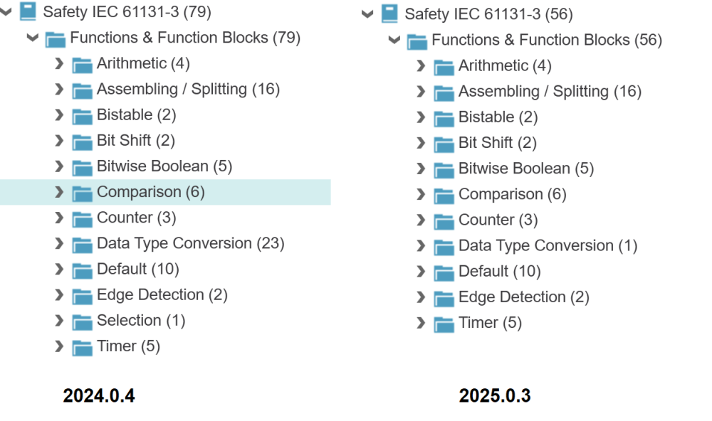

It seems that between 2024.0.4 and 2025.0.3 the Safety IEC 61131-3 has decreased from 79 to 56. Have these blocks been moved somewhere else?
Data type conversion has only 1 block left and selection seems to have disappeared.

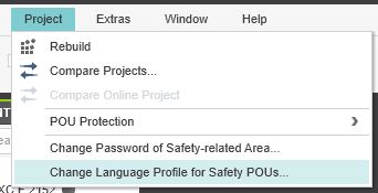

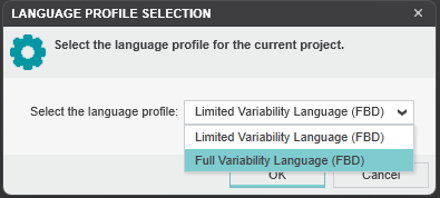

please check if you’ve enabled the Full Variability Language profile
After reloading the project it should show you the 22 missing conversion functions and the seletion function.
