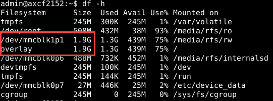

i just only put the SD card on the slot of AXC F 2152 and like the below picture , any more steps ?
Untitled Image
No, that should be it.
You should now see the additional space in the user file system:
