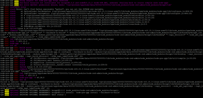

Hi Stefan, I thank you for the quick repsonse. I know that the standard procedure is the same and i have already done it but unfortunately it does not work. I better describe my situation:
* I have performed a factory reset of the PLC
* I have installed the latest version of the firmware downloadable from the site (2020_0_1_LTS)
* I have installed Node.js version 12.16.1 LTS using the offline procedure
* I have installed Node-red using command: npm install -g node-red
* I have installed node-red-admin using command: npm install -g node-red-admin
* I have created a password with command: node-red-admin hash-pw
* I have opened settings.js and i have uncommented the section related to Auth and i have paste the password

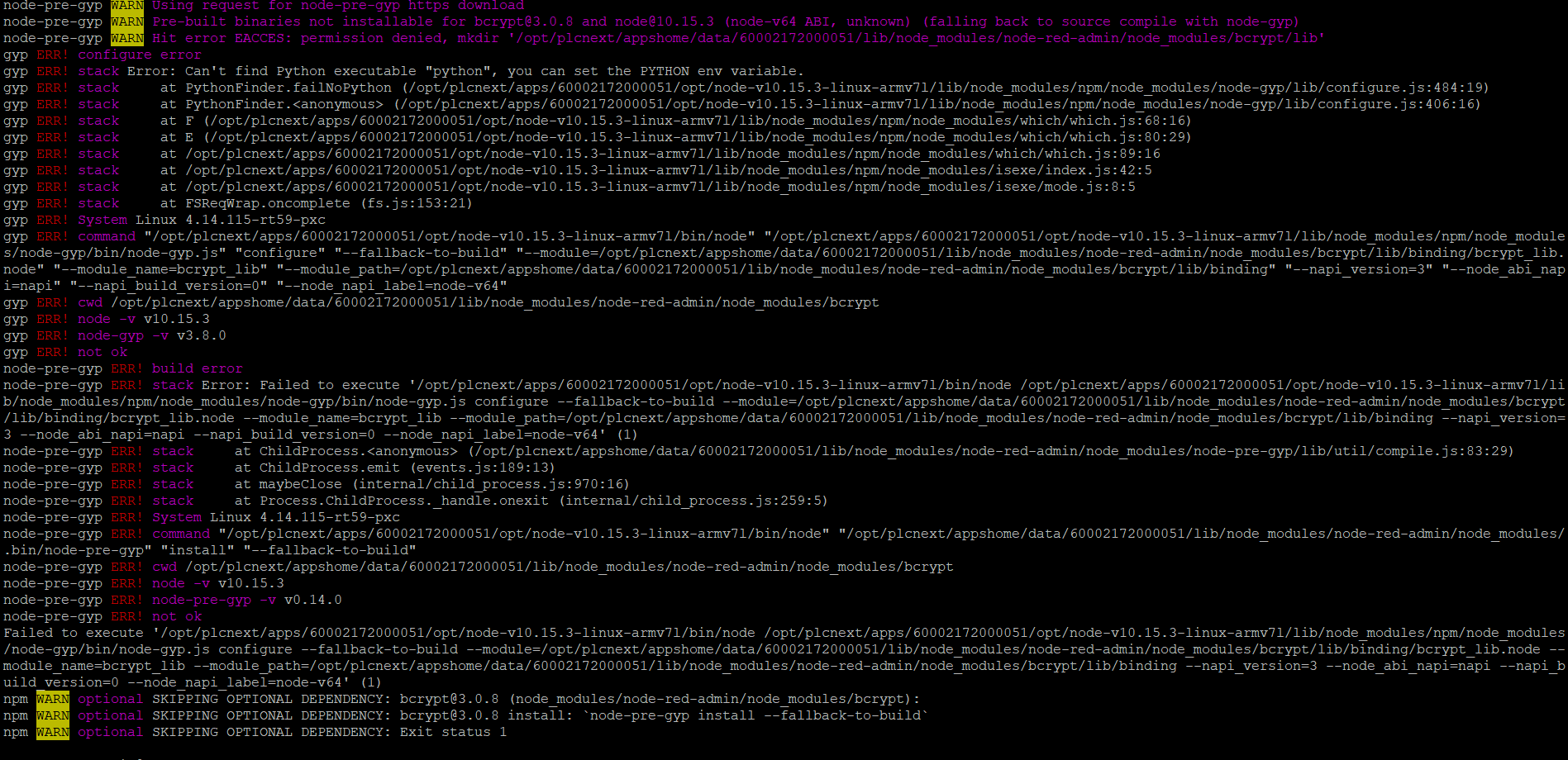

I have noticed that during the installation of node-red i see many errors as shown in the image attached. Maybe i have to install some other packages before installing node red. I am wrong with something during the installation?
Hi Pietro, when I have a look at your errormessages it looks like Python is not properly installed on your device. Please try to install or update Python. There is a description in the makers blog. There is also a message like unsufficient access rights. Have you tried to make the installation as root?
Hi Stefan, I have done all with root account. Following your advice, i have noticed that no version of python is installed on the PLC: if i use command: python --versione the system responde me: -sh: python: command not found. I have looked in the markers blog but i have founf only the procedure that uses the following command: /opt/bin/ipkg install python3. This command is no longer valid. Is there another way to install python on the PLC? Thank you very much for your help
Hello Pietro, what do you mean by “The command is no longer valid”? Befpre you can use the command, you have to install the package manager ipkg as decribed in the makers blog. After that you should be able to install python. Here are my steps: wget -O – http://ipks.nslu2-linux.org/optware-ng/bootstrap/buildroot-armeabihf-bootstrap.sh | sh export PATH=$PATH:/opt/bin:/opt/sbin sudo ipkg install python3 sudo install py3-pip pip3 install --upgrade pip sudo ipkg remove py3-pip
