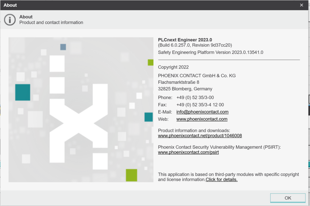

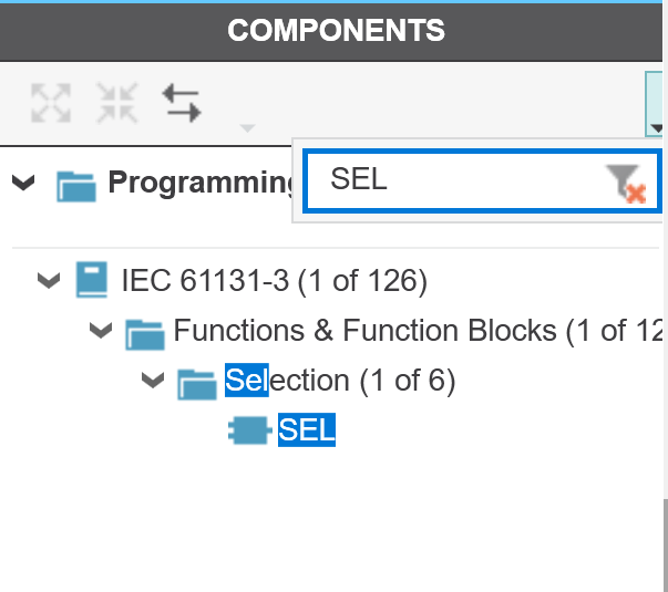

I’m using plcnextengineer 2023.0 LTS with a SPLC1000 and in the safety IEC blocks i cannot find the SEL_S block. Is there another library that has this block? There are 56 block in the safety IEC but no SEL_S.
Not all standard functions blocks have safety equivalents.
Was the SEL_S function block available in an earlier version of PLCnext Engineer? I don’t see it in version 2022.0 either.

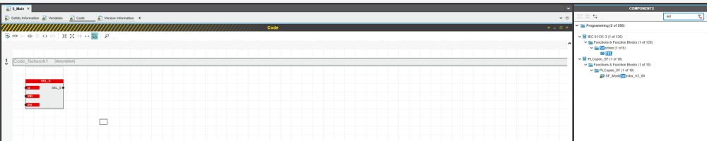

SEL_S appears in the PLCnext help, but can’t be found in the components area. However if you try and add an SEL_S function to a safety program it lets you add it by typing the name in manually:
So it looks like the function exists, but is hidden from the components area?

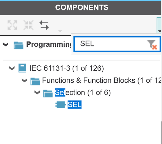

I have heard back from the PLCnext Engineer support team.
Apparently you can make these blocks visible by changing the “Language Profile” in the Project menu, then closing and re-opening the project:
Project Menu ');\n mywindow.document.close(); \n mywindow.focus();\n setTimeout(function () {\n mywindow.print();\n mywindow.close();\n }, 1000)\n return true;\n}\r\n\r\n\r\n I hope this helps.
Hello Martin, that worked for me. Thank you!
