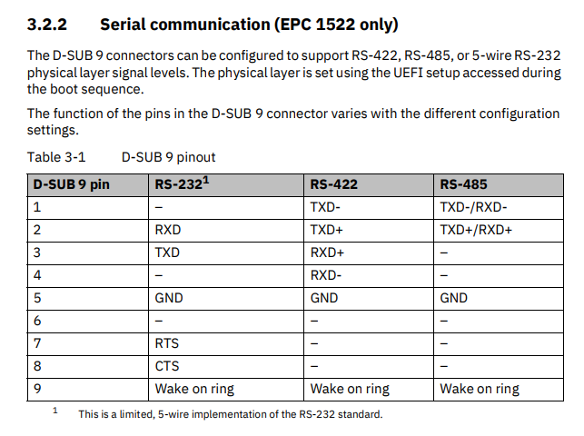

Here are some relevant snippets that I’ve been able to find:
* The user manual (UM EN EPC 1502/1522, Revision C, 2024-04-03) says that the serial ports are configurable through the UEFI Boot menu:
* … however in this recent conversation, it was stated that the boot menu cannot be accessed by users:

So, to answer your questions/statements:
_In PLCnext-Engineer I can not find anything about the serial ports._
That's correct. PLCnext Engineer does not support the serial ports on an EPC 1522 device.
_Also on the WBM there is no overview or settings for the serial ports._
That's correct. Serial port settings on an EPC 1522 cannot be changed from WBM.
_as these are ports with multiple options (RS232/RS422/RS485), there shout be a way to configure this and finally use them._
You would think so, but unfortunately that is currently not the case.
