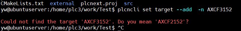

Set target AXCF3152
Can’t the project of axcf 3152 device be targeted?
What’s the problem?
best regards
What is the result of this command:
plcncli get targets
? If you don’t see a target with the name “AXCF3152”, then a suitable SDK is either not installed or not known to the plcncli.
What is the result of this command:</p>
plcncli get targets\n<\/pre>?<\/p>If you don't see a target with the name "AXCF3152", then a suitable SDK is either not installed or not known to the plcncli.<\/p>
