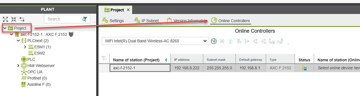

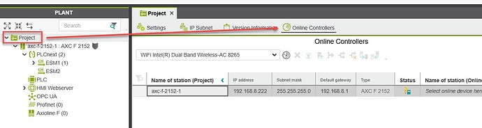

Hi Matthias, Are you able to discover the PLC in the “Online Controllers” window? (after making sure the correct Ethernet adapter is selected) [attachment]2021-04-15_11-10-12.jpg[/attachment] That would be the typical way to discover and re-assign the IP address on a PLC. Once you can see the PLC in that window, you can transfer the IP address settings from the online controller to the PLCnext Engineer project, after which PLCnext Engineer should be able to connect to the controller. ~ Martin.

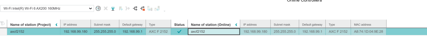

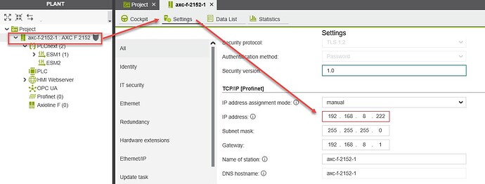

Thanks Martin! I followed your instruction and found the controller through the project settings (see attached image). However, I still cannot connect to the controller (see attached image) since PLCNext Engineer is not happy about the IP address in the settings. Best, Matthias
I also changed the IP range which fixed the issue with the IP range issue that PLCNext Engineer didn’t like, but I still cannot connect. Best, Matthias

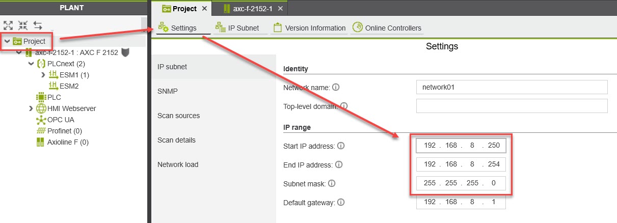

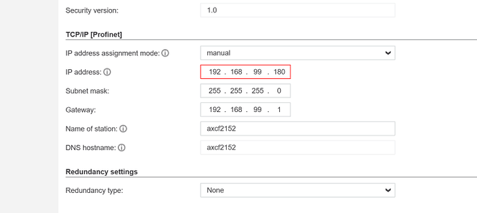

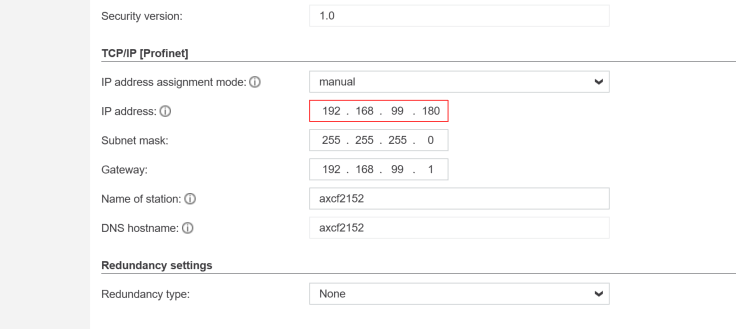

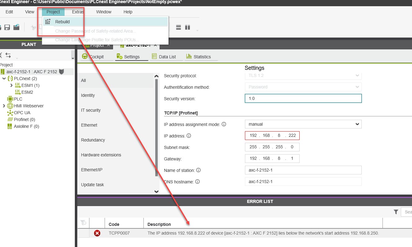

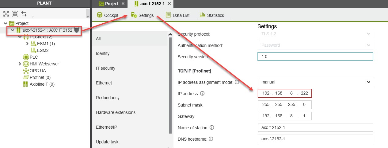

Hi Matthias, I can reproduce that error by setting the IP address of the device outside the range of IP addresses that are in the project settings. Here is the IP address range in the project settings: [attachment]2021-04-15_22-17-35.jpg[/attachment] Here is the IP address of the device. Like in your case it is outlined in red, because it is outside the range of IP addresses set above. [attachment]2021-04-15_22-18-27.jpg[/attachment] When I build the project, I get the error shown below, telling me exactly what the problem is. [attachment]2021-04-15_22-19-13.jpg[/attachment] Do you see something similar when you build your project? ~ Martin.

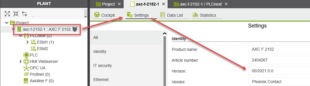

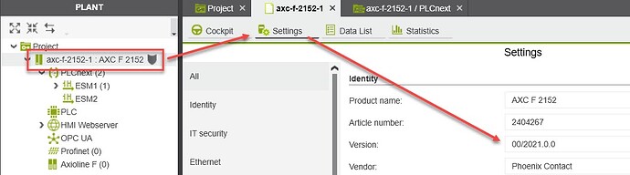

The version of PLCnext Engineer does not make any difference. This is what I mean when I say you can see the device version in PLCnext Engineer in the “Settings” window of the device: [attachment]2021-04-19_8-08-19.jpg[/attachment] The device version in PLCnext Engineer must be compatible with the firmware version on the device. For example, if you have device version 2021.3.0 in PLCnext Engineer, this will not work with any current firmware, since FW version 2021.3 has not yet been released for the AXC F 2152. This would explain why the earlier version of PLCnext Engineer worked, because device version 2021.3 cannot be selected in PLCnext Engineer version 2020.6. ~ Martin.
