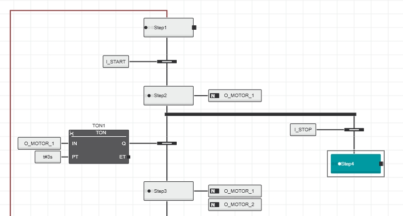

Hello all, a colleague and I regularity program sequential systems and as such will use the SFC language frequently. What we are trying to figure out is if there is a way to put a basic boolean expression directly into a transition as you can with an action. This function would allow much cleaner and faster programming using the plc next platform.
You can see an example of this function being supported in an action however I can’t find how to do it in a transition without using the “transition” component on the right of the screen.
image002 (1).pngAny suggestions?
Hello, simply right click on the transition and select “inline transition”

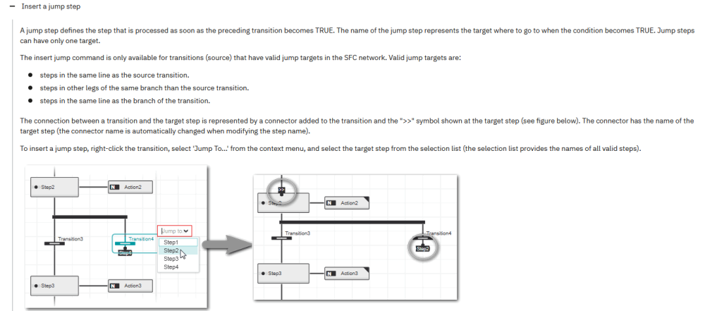

I have a similar question. In the example, I want to jump from Step4 back to Step1. How can I do this?
Found the answer:
