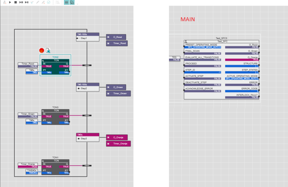

I was trying to make my first SFC with PLCnext engineer and I wanted to create a simple traffic light FBD.
So I noticed the Q from te TON function blocks stays on and the Output from the function block ‘‘Test SFC’’ keeps flashing on and OFF. After a lot of try and error and debugging the problem it was resolved If I enable ‘‘Evaluate_all_transistions’’…

My PLC engineer version:
image.pngPLC: axc-f-2152 (Starter kit)
FW: 2023.0.0 LTS (23.0.0.65)
HW: 06
Hi seafoxc,
Imo the described behavior does not seem to be strange if we operate with the assumption that the default state is that only the transition for the active step is evaluated (opposed to the option Evaluate All Transition). Thus the code in the network connected to the other transitions is not executed. Meaning the variables etc keep their last values if they are not written by other parts of the program.
When you enter a new cycle the transitions evaluates to be TRUE because the TON remained TRUE because it wasn’t executed every cycle and the first thing your code does is setting the action variable for TON.IN to TRUE (before the FB is called). So it keeps the output TRUE. That would cause the program to rush through all steps causing flashing outputs.

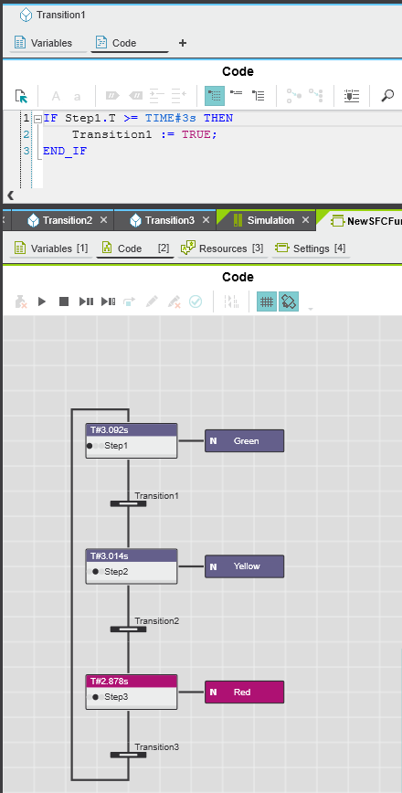

Food for thought:
You can realize your traffic light easier by using coded transitions. In those transitions you can access the time the step is active via StepName.T and use it in a condition to set the transition.

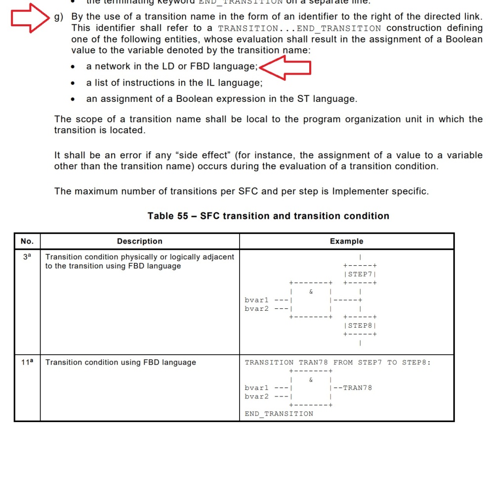

Hi I will try to get my reasoning on paper as best as I can :-).

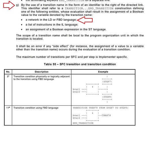

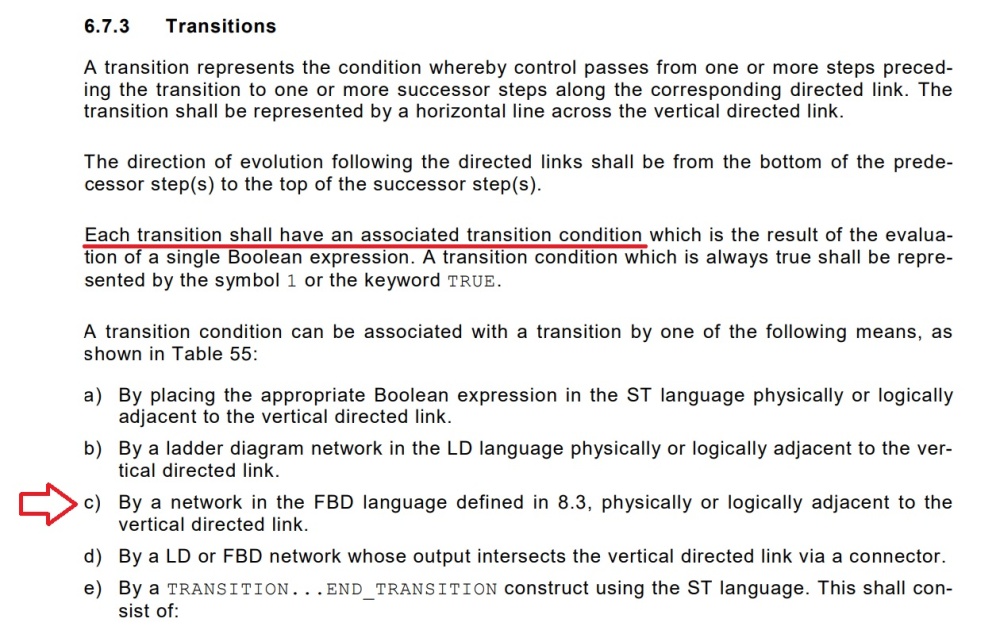

So from the standard:
So we have a transistion condition. And you have a lot of ways to connect this transistion.
So it should Work as Inline or as transistion. Then I made a test program to see if it makes a difference if you use it inline, in a transition or for good measure I als tried ST (With the TON timer).
In the video you can see the 3 FB’s with the decribed methodes. I will also add the program to this post.
SFC TON Timer behavior
You can see when you load the program the first run works as intended for al three of the Function Blocks. The second run it is as all transitions are True. (The last FB I set the time for the orange light to 6 seconds instead of 3 seconds so it ‘bugs out’ al little later.

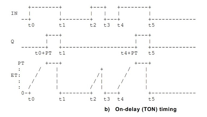

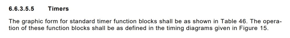

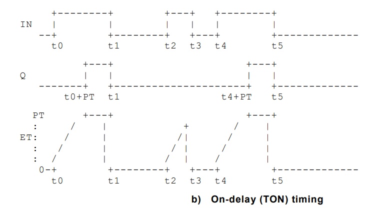

The the working of the TON block in the standard:

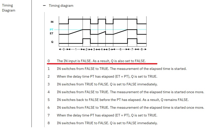

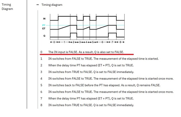

And here print screen of the Phoenix contact help:
So if it evaluates the transition condition it should evaluate the TON timer and the result should be false. But the standard does not specifiy the code that should be use for the TON FB. You can not see the code behind the standard FB’s (Blogpost on the forum).

Okay it does not deviate from the IEC61131-3 because it doesn’t say wether all transitions are always evaluated or not.
I can only assume that there is reason why it behaves the way it does and the input “Evaluate all Transitions” exists is to be able to run projects like in PCWorx or Siemens.
