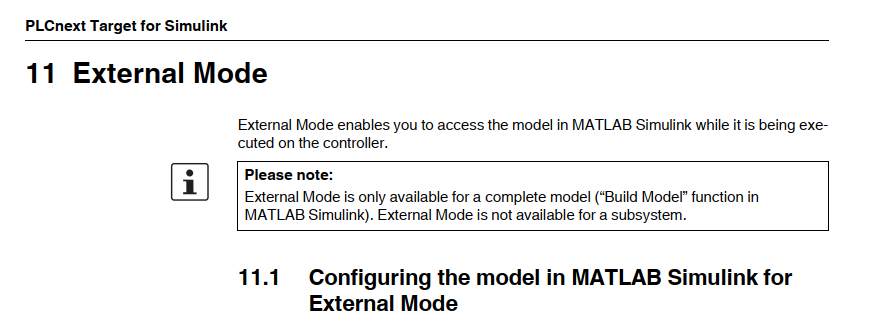

In the video it comes how the option to run in external mode is taken, but it is an old version.
In my current matlab version it won’t let me put external mode.
Is an app needed to carry out said external mode?
You’re right, those videos are quite old. There is work currently underway to update them. The User Manual is more up to date. Page 62 of the user manual (which you can download from the Phoenix Contact website) describes External Mode:
