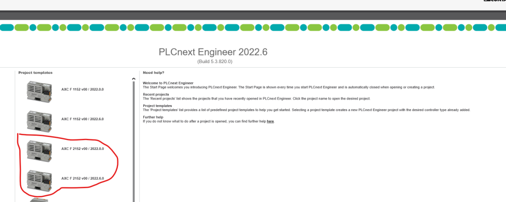

I will receive the plc SOL-SA-PCU-41XX, how can I program it in the plcnext engineer program as in the AXC F 2152?
Adding some of these two templates would work
Or do I have to do something else?
greetings
You can use any template for AXF F 2152 with corresponding firmware (to your PLC).
In terms of hardware, the SOL-SA-PCU-41XX is a 1:1 AXC F 2152.
Hello,</p>You can use any template for AXF F 2152 with corresponding firmware (to your PLC).</p>In terms of hardware, the SOL-SA-PCU-41XX is a 1:1 AXC F 2152.</p>
Ok perfect, thanks for the support greetings
