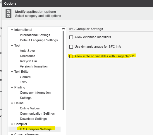

Please try setting the following compiler option: [attachment]image001.png[/attachment] I would be interested to know if this solves the problem.
