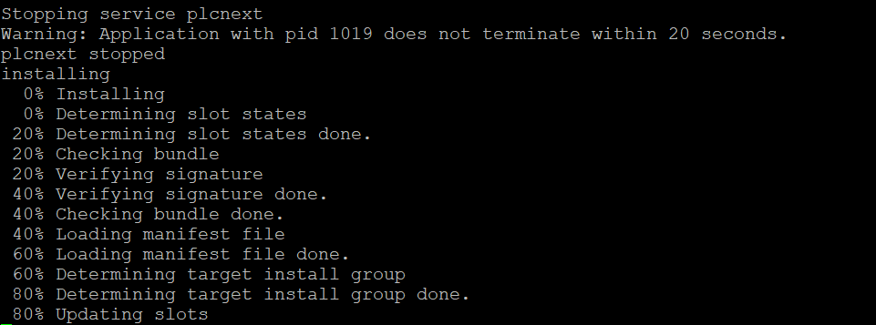

During the update process the progress would be interrupted around 80% all the time. See next image.

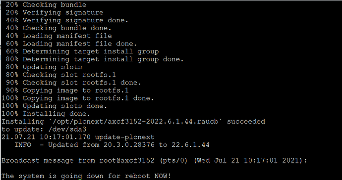

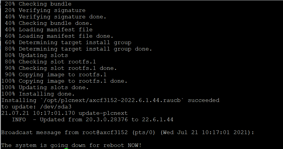

2. Performed a new firmware update from the shell.
A successful transfer looked like this on the shell.
