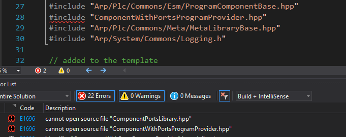

Source file not found in ComponentPorts example
I am trying to run the ComponentPorts example from the CppExamples git repo. https://github.com/PLCnext/CppExamples/blob/master/Examples/ComponentPorts/src/ComponentWithPorts.hpp I copied over the files in the src folder from the repo to my acf project. I then got the following compile errors. Not sure where I can find the source files mentioned below.
Based on the contents of the source files, that project is based on a PLM project, not an ACF project.
