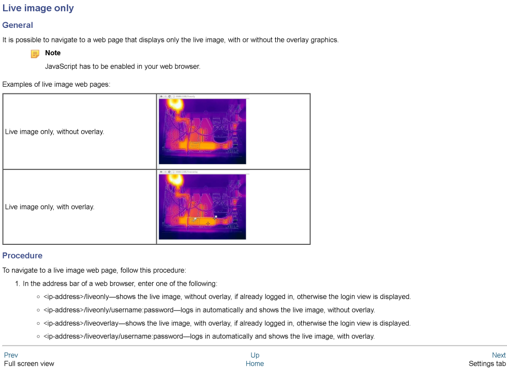

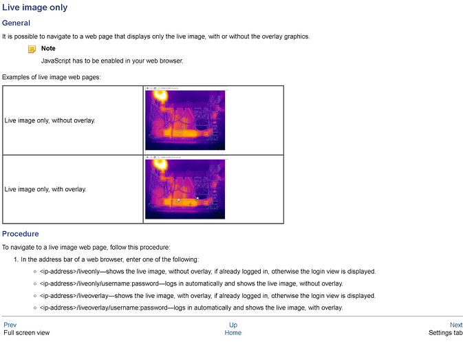

I’m using a Flir AX8 camera connected on the same subnet as the PLC and the on click event uses the procedure as stated below as the address for the footage.
