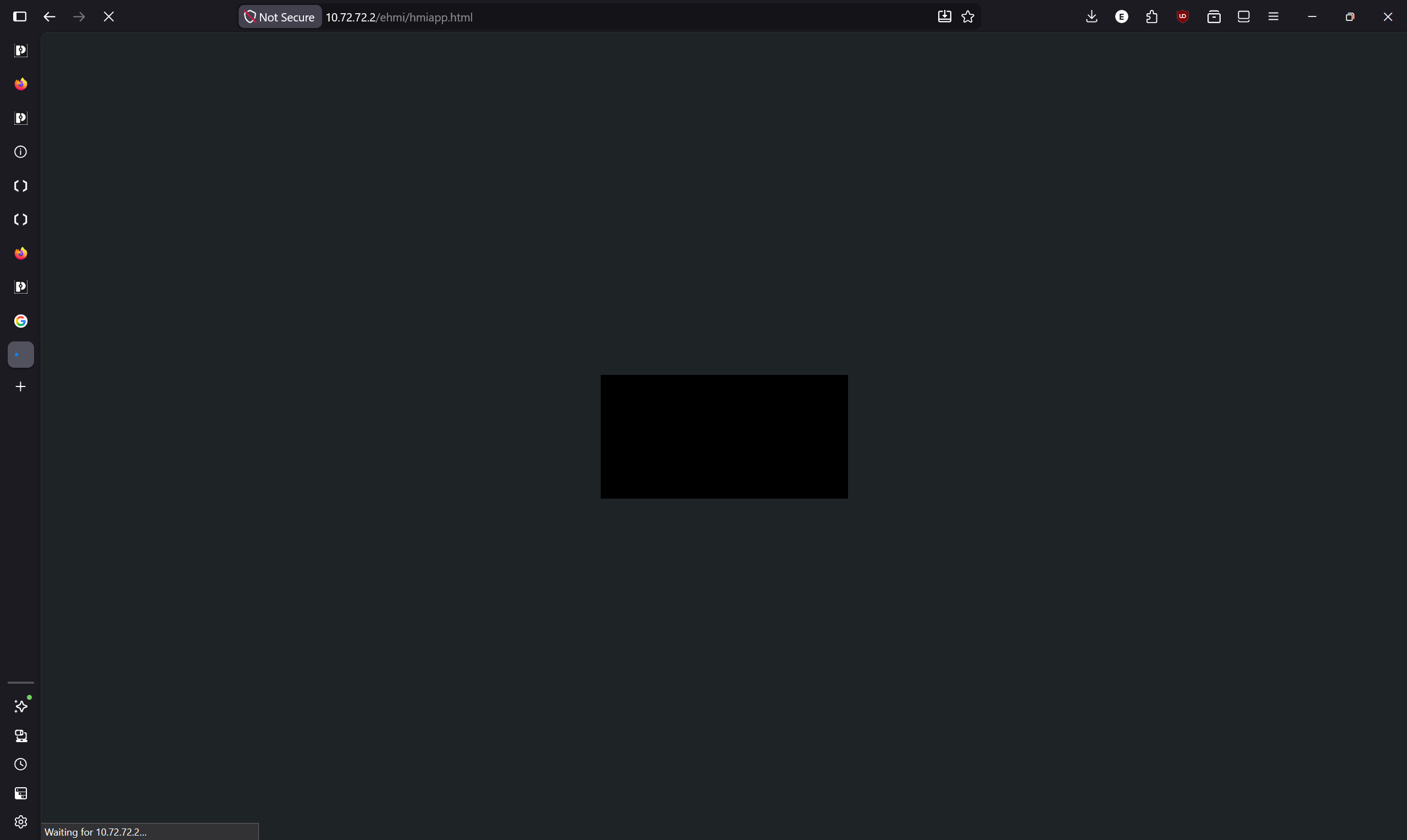

I am struggling to connect to an AXC F 3152 over VPN using a TC Router 3002-4G GL.
The connection seems to somewhat work since I can ping the PLC but when I try to open the web HMI it only shows this initial screen with the black rectangle in the middle.

Changing the Packet data mode to PPP seems to have done the job.
Increasing the timeout duration also dealt with the intermittent disconnections after that, thanks DivisionByZero.
