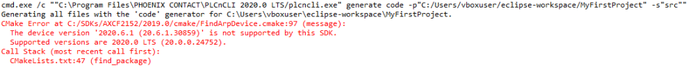

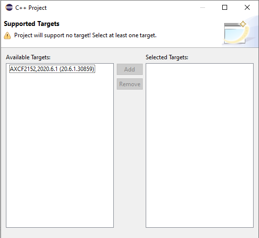

I recently started working with the PLCNext platform. I am trying to install the C++ sample on the controller. Unfortunately, I always encounter the following bug in eclipse.
So my question would be wehere can i get the right target? Or do I have to update the firmware of the target?
I’m working with the following PLC:
AXC F 2152, Ord-No. 2404267
Thanks in advance for the help
Kind Regards
Hello sipru09,
the FW/SDK-Version 2020.6.1 is 3 years old and not supported (no LTS-Version). I would like to recommend to update the Controller to the latest FW LTS Version 2023.0.
Please download the version 2023.0 under following download link, the SDK 2023.0 is part of the firmware package:
https://www.phoenixcontact.com/en-pc/products/controller-axc-f-2152-2404267#firmware-link-target
BR Eduard
