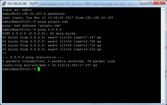

Hello Konrad, I had a similar problem when I updated the PLC firmware. In my case, this fixed the problem: https://www.plcnext-community.net/index.php?option=com_fss&view;=faq&tmpl;=component&window;=1&faqid;=107&Itemid;=433⟨=en - Martin.
Thank you Martin! That was the answer!
