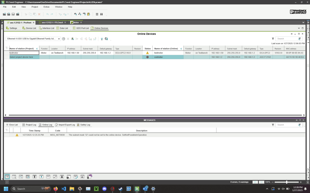

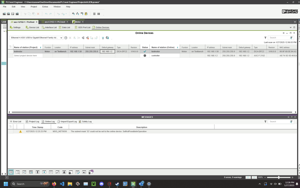

I am trying to connect an SEW eurodrive motor to an AXL F 2152 plc, and I cant seem to figure out this revision issue. I have both flashing BF-D and BF-C on my controller, so i assume the communications issue I am having is due to this.
I am able to get the profinet to show the device status as OK (shown above), but as soon as i move to a different tab and come back it immediately gives this warning below and unmerges the revision number.
am I missing a save or apply button or something to get the revision # to stick?
the revision problem is just a warning and does not have an impact on the Profinet communication.
The reason for the revision mismatch can be found in the type column. The string stored on the device is different to the string from the GSDML file. The green checkmark indicates that your device is correctly identified and the parameters have been transferred. Please go to WBM of your PLC and check the Profinet diagnosis.

image.pngFrom my workstation I can ping both the motor (192.168.1.50) and the PLC (192.168.1.10).
Can you check if the motor has the proper device name assigned? You can click on the device name in the Profinet diagnostics to open the WBM of the motor.
image.pngimage.pngthe name “testmotor” is in both the PLC and the motor
