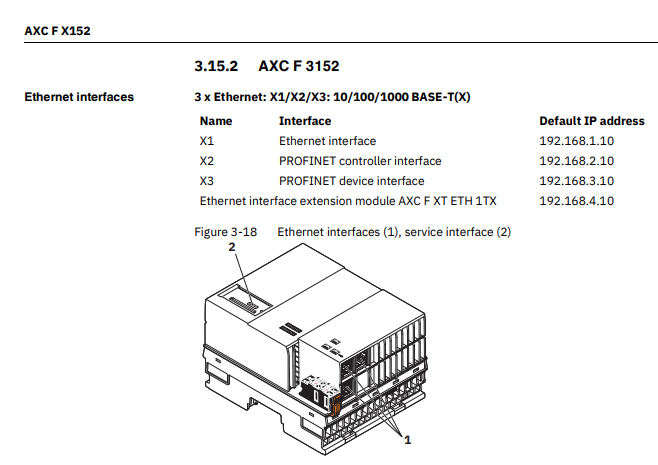

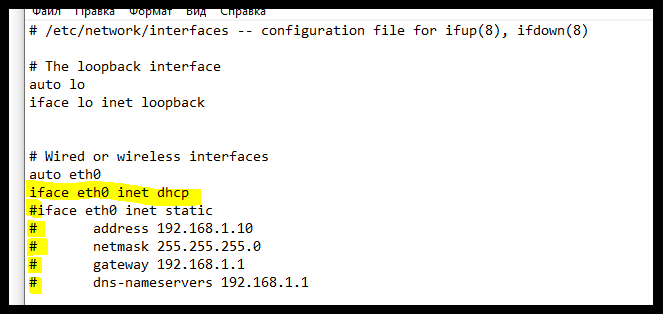

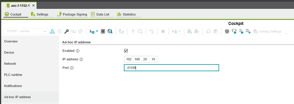

Yes, I did this, now. The IP Address is reseted now:( ?? That means I have no access to this controller, now. After that I tried to adjust my old IP in PLCNext Engineer 2020.3 but I see only a donut. Then I restarted PLCnext Eng. again. I see the controller, but I cannot chose anythink. I repeat to refresh, but the same issue

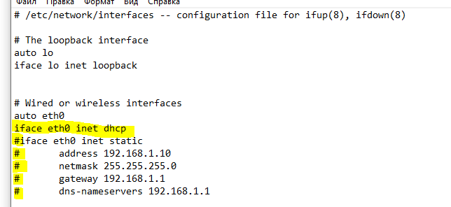

How can I set IP without PLCnext Engineer? ![PLCnext.PNG]()
