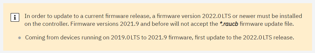

I’m not sure if you’re aware of this note in the PLCnext Info Center:
Administration - Firmware Update
Note: To make sure that software or firmware files downloaded via internet have not been corrupted or tampered, perform an integrity check of the downloaded files. You can find further information in Integrity check of downloaded files
So updating the firmware on your device after a Type 2 reset is a two-stage process:
                                                                    1. Update to version 2022.0 LTS.
                                                                    2. Update to version 2023.9.
