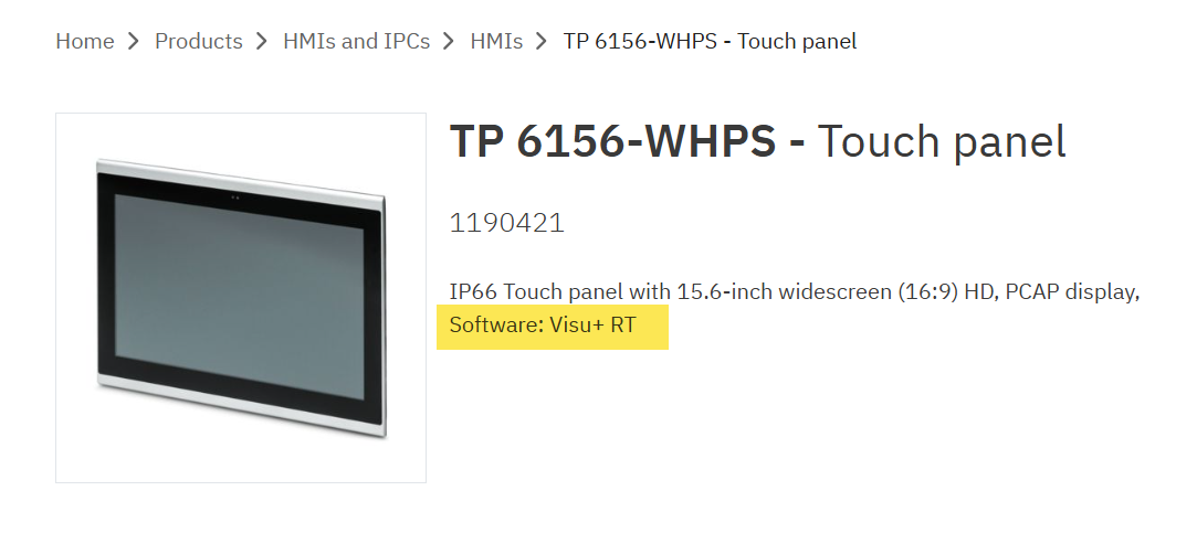

I have the Phoenix TP 6156-WHPS display (1190421). My understanding was that it was supposed to have a web browser, however I’m having difficulty locating any settings where I can set a URL to display our HMI Web server application.
That HMI is intended for Visu+ applications, not for web-based applications:
For more information about that HMI, or to get help selecting a suitable HMI for web-based applications, please get in touch with the Phoenix Contact office in your country, and they’ll be happy to help.
