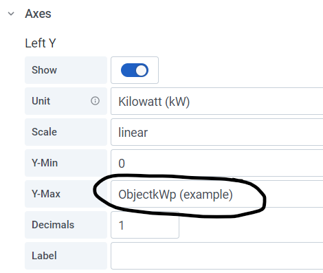

Is there a way to define the Max value in the Y axis in a graph that is not Auto or a fixed value? As an example i would like to set the Y-Max based on the device information. In my case it’s different Solar parks. Each installation will have a defined kWp (peak power). I would like to use either a tag on the device (or if the Y-Max value can be set through an API)
Best Regards
/Erik
Hey Erik,
Unfortunately, it is currently not possible to use queries in the axis definition area.
However, we have found another solution that will probably have the same result - please have a look at this video: https://proficloud.io/knowledge-hub/faqs/time-series-data/in-graph-visualization-how-can-i-have-the-maximum-value-of-the-y-axis-based-on-a-variable-metric/
