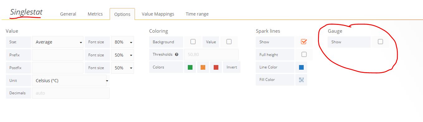

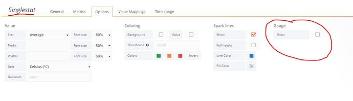

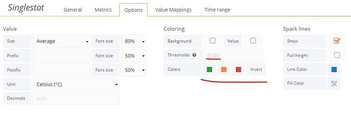

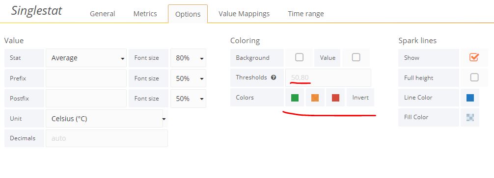

Need Guage and Traffic Light Indicator for One of the Project Regards Chetan
Hi, you can use for both the “Singlestat” panel. There you can choose the option “Gauge” or also the coloring with the thresholds. Regards, Arno

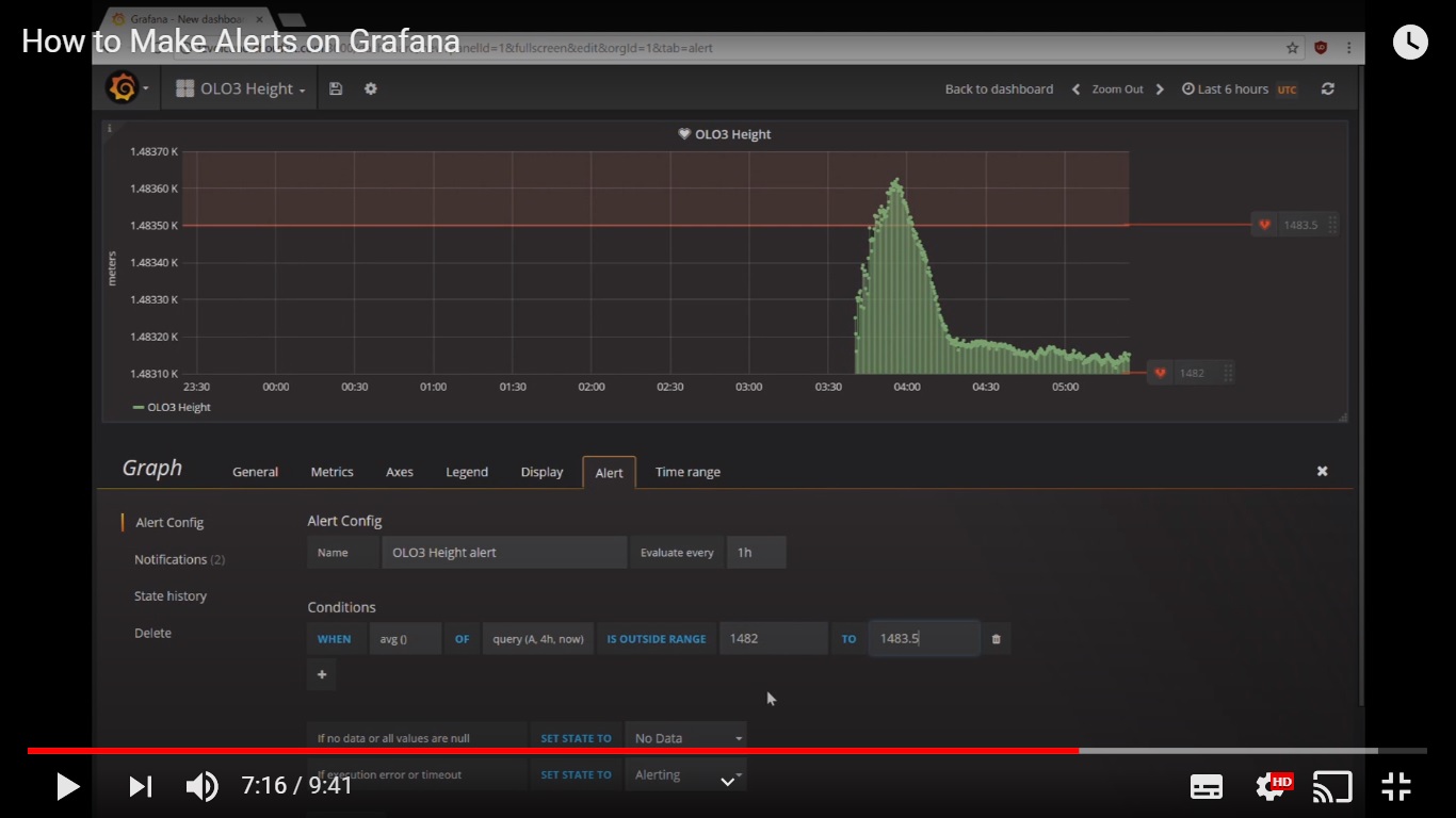

Hi I’m trying use and configure the “alert list” plugin. It is available, but the function to configure isn’t. I watched some videos on youtube how use this same plugin and I didn’t find tha same option to configure the alerts in proficloud TSD Analitycs.
                                               * **[](https://grafana.com/docs/grafana/latest/guides/whats-new-in-v4/)<https://grafana.com/docs/grafana/latest/guides/whats-new-in-v4/>**
I read one oldest post, that probabli it would be available end May. Thank you
Hello, Unfortunately, In Proficloud TSD Analytics, the alert list plugin cannot be used. ~ Martin.
