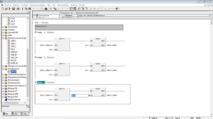

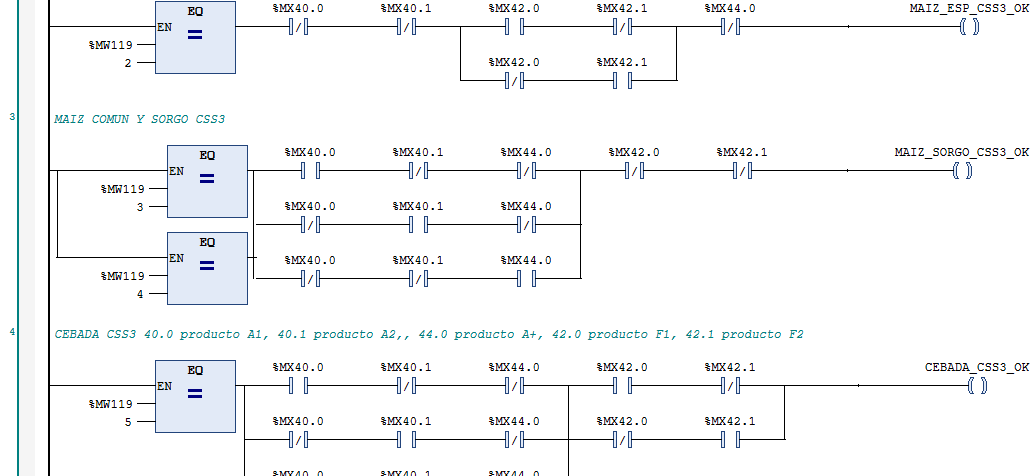

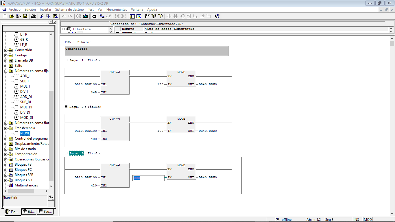

That SEL function would not work for what we want to do, for example, I have three sensors, according to which one is activated, I want to move a value to make a count or comparison or move a time, the sel function that will be last is the one that goes If the value is saved, if it is true, it will move that value(IN0), otherwise it will move the value it has in that last(IN1) SEL function. I do not understand how simple things Phoenix Contact complicates it. I also do not understand how they get the EN / ENO function, if one wants to make an account if a certain logic is given
[quote]That SEL function would not work for what we want to do, for example, I have three sensors, according to which one is activated, I want to move a value to make a count or comparison or move a time, the sel function that will be last is the one that goes If the value is saved, if it is true, it will move that value(IN0), otherwise it will move the value it has in that last(IN1) SEL function. I do not understand how simple things Phoenix Contact complicates it. I also do not understand how they get the EN / ENO function, if one wants to make an account if a certain logic is given[/quote][attachment]Schneider.png[/attachment]
Hi Luciano, If you would like to reproduce the logic shown in your picture, and if I am reading that logic correctly, then you do not need to use the EN/ENO feature, or SEL blocks. In your picture, since the EN input on all the EQ blocks is always true, this is identical to the EQ block in PLCnext Engineer without an EN input.
Martín, I THINK THAT THE EXAMPLE I WAS NOT THE MOST CONVENIENT FOR YOU TO SEE WHAT THE MOVE FUNCTION IS VERY IMPORTANT WITH en / eno. THIS EXAMPLE IS WHAT I WOULD LIKE TO DO. In version 2021.0.1 the MOVE function did not work, in the latest version it does not allow me to use the instruction with EN / ENO
Hi Luciano, OK, that latest example is a common case where EN/ENO on the MOVE function would be useful. As discussed earlier in this thread: [list] []The EN/ENO feature in version 2021.0.x did not work as expected. []The EN/ENO feature has been removed from version 2021.3. [*]In cases like the one you show, it is possible to use a SEL block to reproduce the behaviour of a MOVE block with EN/ENO, similar to this: [/list][attachment]2021-03-24_12-46-38.png[/attachment]
