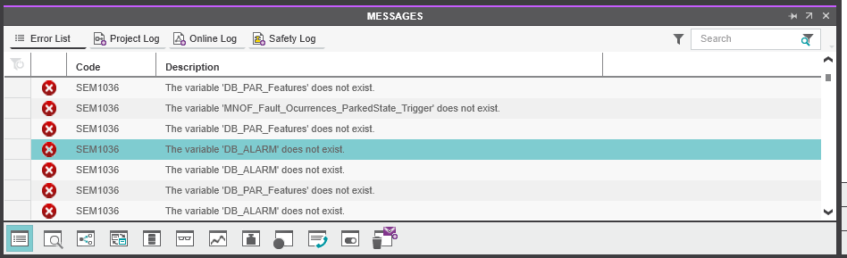

Variable does not exist despite being declared as a global variable

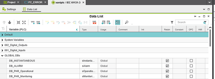

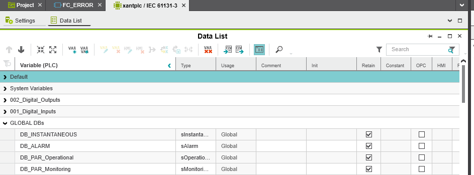

I have declared a couple of global variables as shown below. These variables are user-defined structures.
However, despite being declared there, when I rebuild the project, I get the following error messages:
How come these variables aren’t recognized properly? What am I doing wrong here?

Global variables must also be declared as “external” variables in any POU that uses them.
