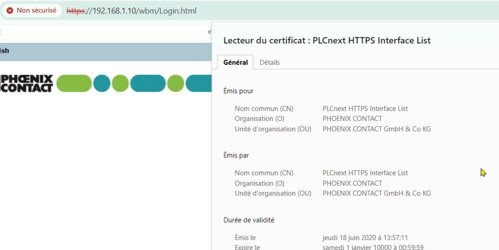

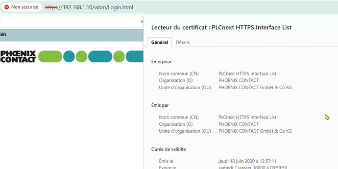

I’m finding the way to enable https in web browser when accessing my 192.168.1.10 AXCF2152 in LAN. The certificate send by plc CN : PLCnext HTTPS Interface List
I tried to download the HTTPS-self-signed certificate in wbm Security/Certificate Authentication and install in browser or via certmgr.msc for installing in windows Trusted Root Certification Authorities but no way.
Is there a simple way to get https connection to the PLC instead of default http with no WAN connexion to get authorisation from server authority ?
Thanks
