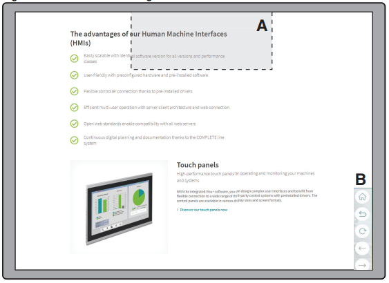

Go to the Cockpit of the panel and under the URL settings, there is a dialog box where you can configure a delay “ Connect to URL after ## seconds..”
Extend this time for the panel so that your target PLC Next device has enough time to boot and make the eHMI webpages available. For your AXC controller, try using 45 seconds to start and then modify it up or down for the optimal delay time that is error free.
If the error occurs still occurs, for the WP 6000 panels you can press specific areas as defined in the settings to open the navigation bar. Default location area A and the navigation bar opens in Area B
From the navigation bar, you can refresh the page and reload the eHMI when it is available or if a communication error that occurs that is not automatically recovered by the WP 6000.
