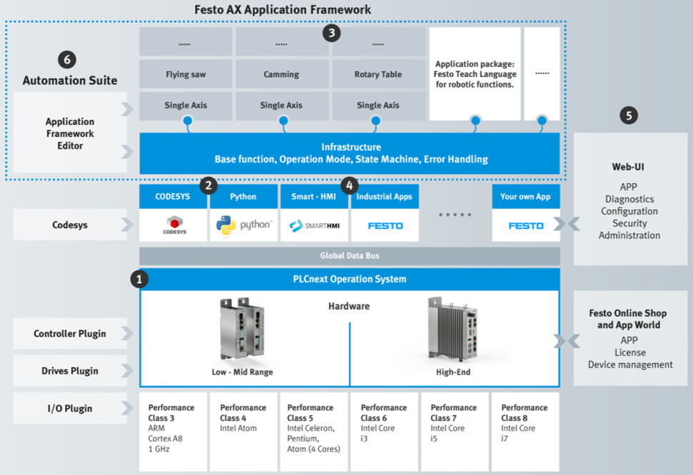

Hi Miquel,
GDS is already available for current Festo AX OS (firmware) version. It is a feature defined and developed by PLCNext. GDS supports real time application. There are application notes explaining how to transfer data via GDS between CODESYS and Python, but the same principle can be applied between e.g. CODESYS and C++ or even any other programs that run in the CEPE. Please refer to the diagram below.
You may find the refered application note about implementation of GDS with the CEPE here: Expert knowledge.
A more detailed explanation of the GDS can be found in the CEPE manual: CEPE Manual.
