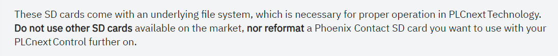

Does it have to be an Phoenix contatct SD card ?
Does it have to be an Phoenix contatct SD card ?Yes.
SD cards These SD cards come with an underlying file system, which is necessary for proper operation in PLCnext Technology. Do not use other SD cards available on the market, nor reformat a Phoenix Contact SD card you want to use with your PLCnext Control further on.
