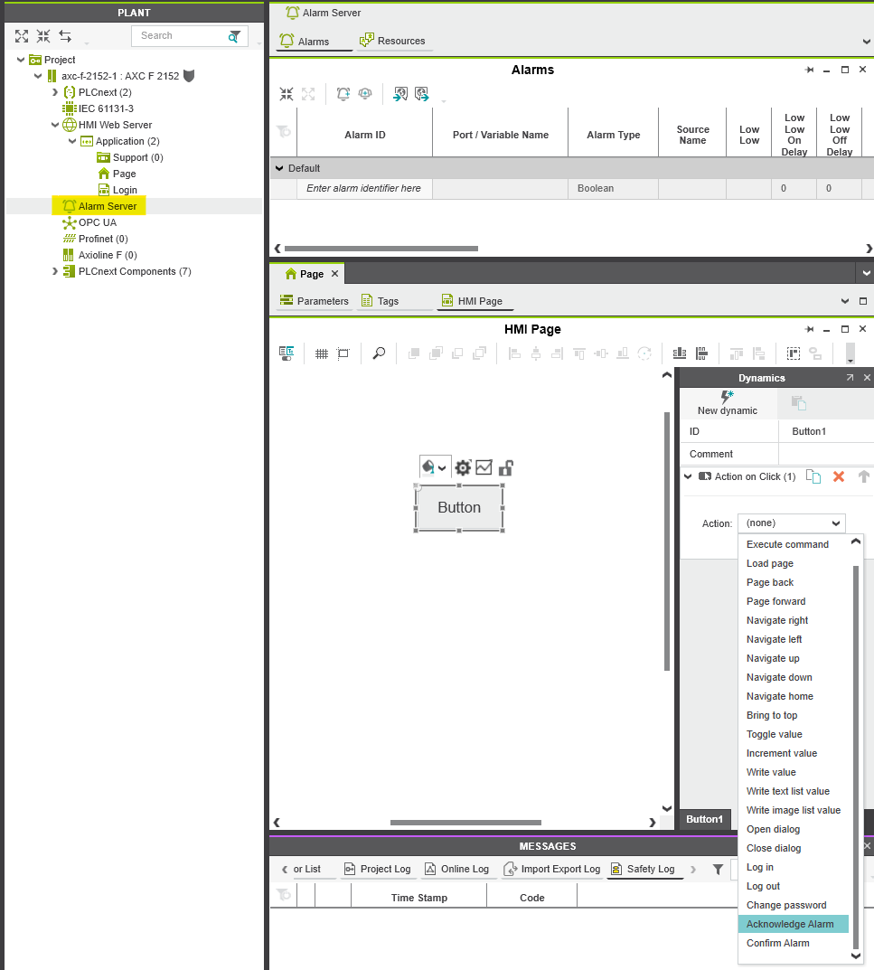

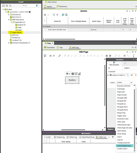

I couldn’t find the help page you’re referring to (but I am using 2024.0.3 and not 2024.0.2). But when I create a new project I can see the Alarm Server node in the PLANT and can create Alarms.
On HMI objects (in my case it’s a button with an Action on Click dynamic) I could select Confirm Alarm or Acknowledge Alarm. I did not go down deeper into this rabbit hole but maybe it’s a starting point for you. For me it seems that instead of dedicated alarm objects in COMPONENTS you’ll have the option to add it to the default HMI objects.

Trying to add a few alarms in the alarm server and linking it to the “acknowledge alarm” action got me nowhere unfortunately. It seems like this new alarming stuff is still in development and not ready for HMI yet
