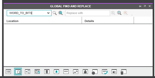

WORD_TO_BYTES function causing error
When i try to upload program containing WORD_TO_BYTES i receive error (screen included)
Can i use some workaround or do i have to use another function?
I use version 2206
![image.png](//forum.plcnext-community.net/uploads/default/original/2X/b/bb0841362cafe54d057a6268fa3d032d76057fd5.png)

I used the function WORD_TO_BITS which gave me that error. I am still having the same error even though I removed the function and removed it in the variables. the compiler does not show where the usage is.
I finally found the culprit. Still, without showing where the error occurs it is very difficult to find the misuse location.
Where did you end up finding it? It seems that I’m running into the same issue
Hi Lucas01,
you could use the global search to find it
Best regards
