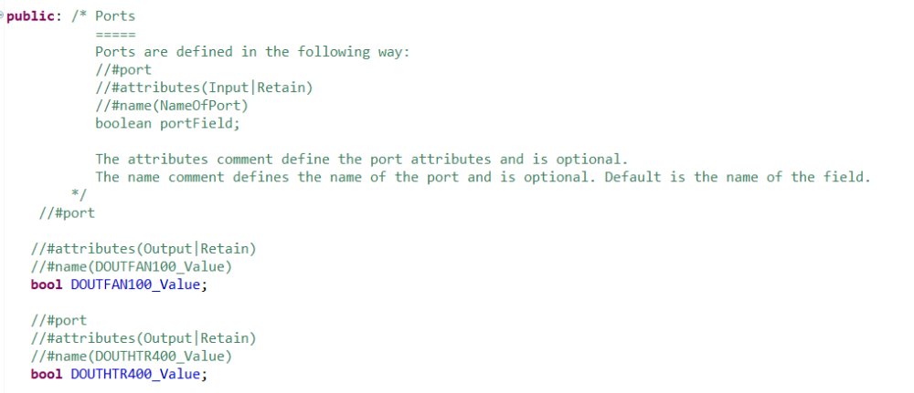

Is it possible to import tags using xml/csv without manually adding ports in C++. Here is a sample of the ports definition.
I do have a ton of tags (about 500 per say) and creating each tag is a tedious task. Just wondering if there is a better way to define the ports. Please help.

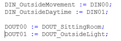

Martin, I was able to get it working. I corrected the IN and OUT port variables in PLCNext Engineer and assigned them to the IO ports. My gds config assigns C++ variable to the IEC variable.
image.pngData flow works as expected and the variables are visible. I just want to make sure this is the right way to do it and I wont see any performance issues in the PLC.
