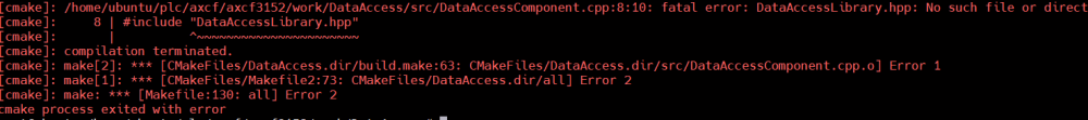

The error of not finding the DataAccessLibrary.hpp file was just my mistake.
But I have another error. I’m trying to work it out on my own, but it’s not solved, so I’m asking. I’m not good enough. I’m sorry.
Error while building the DataAccess project. image.pngI created the project, copied and built the files as shown on GitHub.
I haven’t modified the cpp file or hpp yet.
After copying the source files from the github project to the new ACF project, these commands worked for me with plcncli version 2023.6 and the SDK for AXCF2152 version 2023.6:

I did,
plcncli new poroject -n DataAccess
plcncli set target --add -n AXCF3152
copy src file,
plcncli generate code
plcncli generate config
plcncli build
my plcncli version is 23.0.0 LTS
and sdk is 2023.0.2 LTS

The first command needs to be:</p>
plcncli new acfproject -n DataAccess\n<\/pre>
